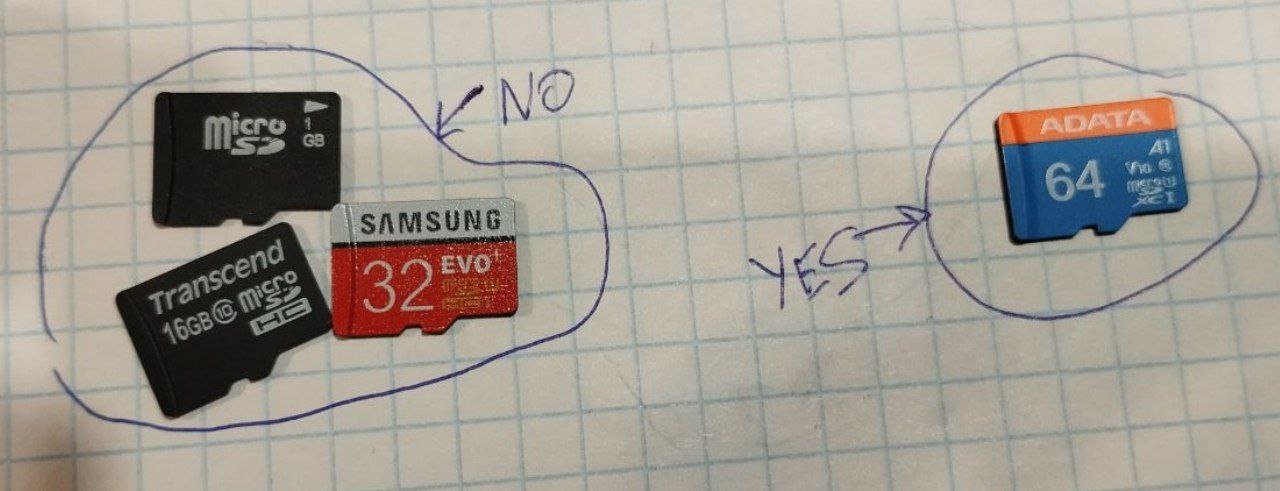

Hello! I did more tests. I install Arduino with ESP32 boards and check SD SPI sketch example.
ALL cards are WORK! 1,4,8,16,32 GB
In the case of esp-idf, only 64GB cards work. What's wrong with the example https://github.com/espressif/esp-idf/tr ... card/sdspi? Where to dig?
I tried different host freq too....

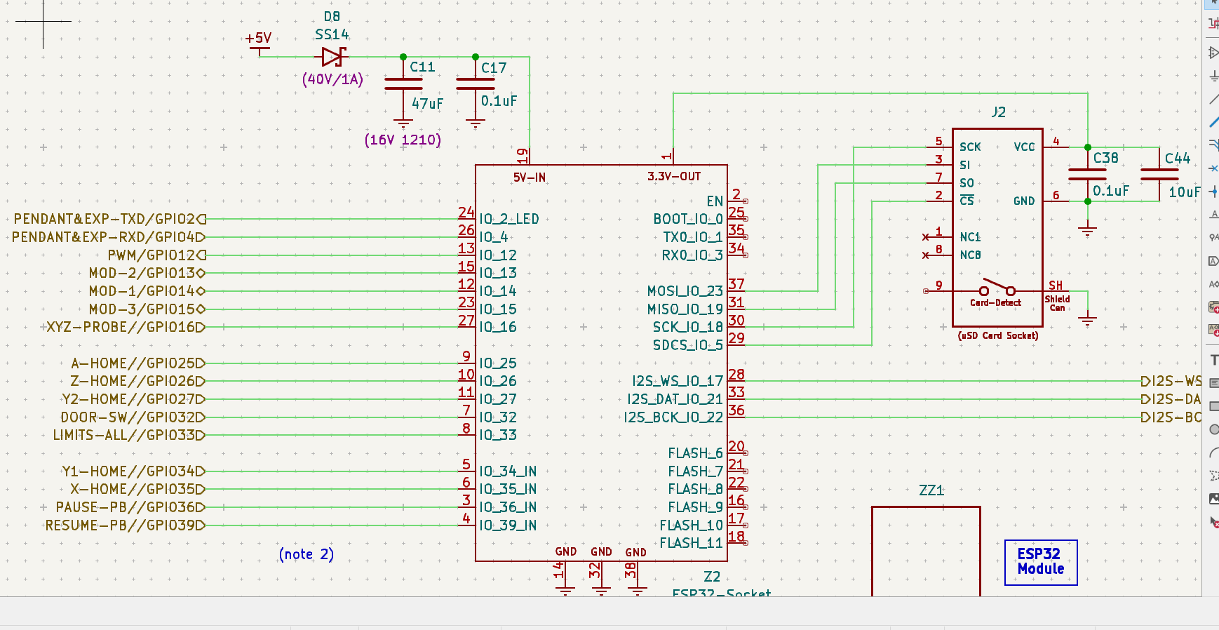

This is what the last thing I tested looks like. The user board is the same, only the wires are even shorter, since everything is separated on the board.
And I've attached the diagram on the first page. Well, all the cards work in the arduino ide.

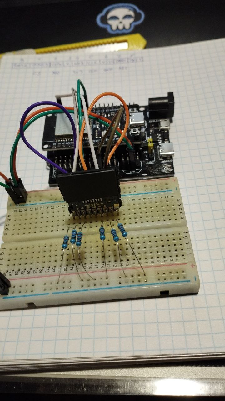

It almost looks like mosi and miso are mixing somewhat -- do you have the 3.3V connected to the pullups?
I checked and pullup all the lines with resistors, checked and pullup each one in turn. In different ways. I wrote about it. Thanks for the help. Do you have any idea why the signals are mixed and the cards are not working?

Sheesh, don't use a breadboard and expect anything over a MHz or so to work well. There is no ground plane so all of those signals are coupling like crazy, lead inductances will be high giving excessive peaks of over/undershoot -- just horrible electromagnetically all ways around.
At least get a little pcb module from amazon or adafruit or somewhere:
https://www.adafruit.com/product/4682
https://learn.adafruit.com/adafruit-mic ... l?view=all
Also, for interconnecting boards, try to use ribbon cable with signals on the odd pins and ground and power on the even lines -- you get a nice rf-ground interleaved between every signal line and can run higher freqs. If you must use a breadboard, you can twist a signal wire with a ground or power wire to keep it from radiating as much.
You can also get some perfboards, solder-through enameled wire, and slug-and-snail tape (which is adhesive-backed copper foil) to make ground planes (with an xacto to slice bits out). Does not take that long to make a one-off that is electromagnetically cleaner:

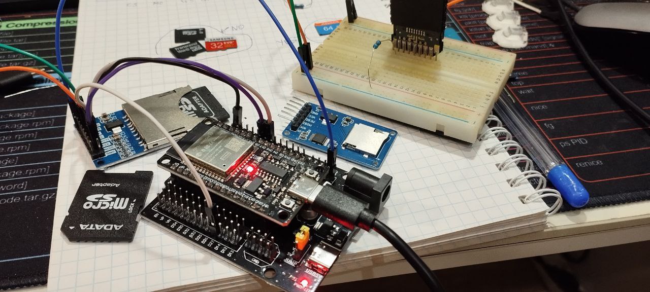

Once again, I reconnected everything with short wires using different ready-made SD card modules. The card was powered via AMS1117 3v3 (not from ESP32).
I conducted a comparative analysis of running programs on the Arduino IDE and on the ESP-IDF
Well, the cards do not work via the ESP-ID example! I doubt that the problem is in the hardware or such, or in the connections. Well, this cannot be - I checked on different ESP 32 models with different adapters.
On Arduino IDE with ESP32 all the cards work. On esp-idf only 1 64 GB card.

teletypeguy
Posts: 10
Joined: Sat Feb 22, 2025 7:21 pm
Re: ESP32 - supported types of microsd cards
Postby teletypeguy » Wed Feb 26, 2025 7:19 am
I am using ESP-IDF v5.3.1 at the moment. I use 4GB to 32GB SDHC cards (formatted with FAT32). Generally I can just format them on windows, but some folks swear by the golden formatter from the sd association:
https://www.sdcard.org/downloads/formatter/
I have used sd-cards on many custom boards, but my current project is using an off-the-shelf Elecrow DLC35010R display module w/ esp-S3. Pullups on the sdcard lines are a mere 47k:
I see they have data1 and data2 lines pulled up as well -- I don't believe that is needed as I have left those lines open on many projects over the years, with various versions of the Chan fatfs code, and different microcontrollers.
This is a custom I did, where the sd tucks under the esp module:
sazanof
Posts: 36
Joined: Wed Sep 13, 2023 10:22 am
Contact:
Postby sazanof » Wed Feb 26, 2025 9:15 am
teletypeguy - thank you!
https://github.com/espressif/esp-idf/issues/15450 I also open new issue on github.
In the meantime, I'll double-check the schematics and check how your code works on my device.
