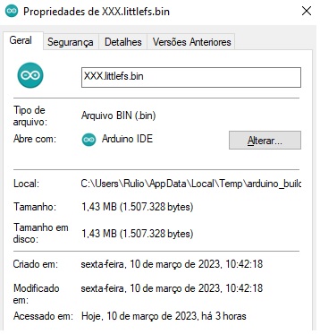

Hello, I have problem to update flash OTA
Connecting to: XXX.s3.amazonaws.com
Fetching Bin: /XXX.littlefs.bin
Got application/octet-stream payload.
Got 1507328 bytes from server
contentLength : 1507328, isValidContentType : 1
Not enough space to begin OTA
Can someone help me?

@Rulioht, that has nothing to do with SPIFFS support in the Arduino v2 IDE.
Please notice the subject title of this forum thread "Re: Arduino IDE v2.0.3 missing SPIFFS upload tool"
You should create your own thread with a subject related to your problem.
