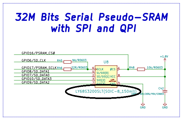

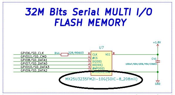

Are you using the Espressif branded SRAM on this board, or something else?
If it's something else, then what is it?

Vader_Mester wrote:Are you using the Espressif branded SRAM on this board, or something else?
you can check shematic it is online and open hard and software
flash:
pSRAM:
