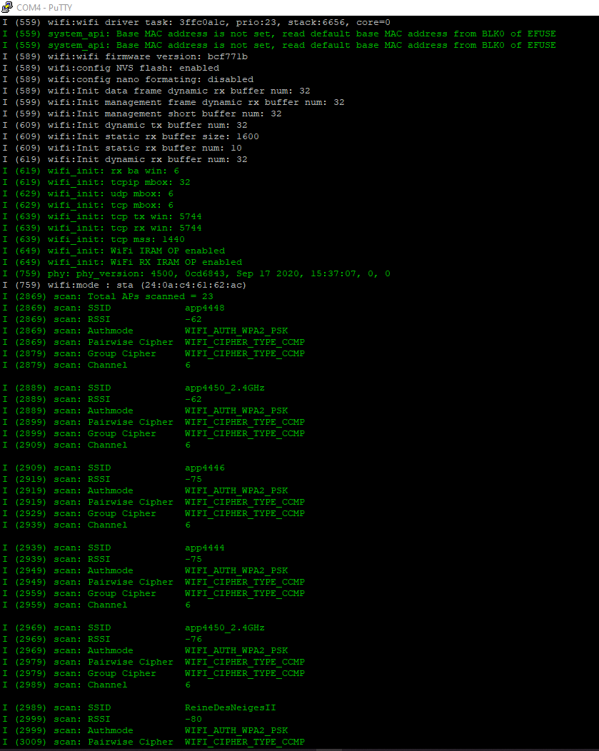

Interesting... thanks for the info. My theory at the moment is that the board isn't able to transmit. I say the "board" because at this point I'm not sure if its the ESP32 itself, the matching network, or the antenna. I think this makes sense with the previous knowledge:
- board thinks it can set up a network, but network isn't visible anywhere
- board seems to sense the AP is there, but fails to auth
- board can't connect to AP since it can't send necessary packets
If I don't find something in the next day or so, I might try replacing the ESP32 on my board with a different one. Will be a pain. Will report back with findings as they arrive.
Re: Custom ESP32 board WiFi connection issues
ESP_Sprite wrote: ↑Tue Mar 23, 2021 3:56 amLooks like some issue impacting WiFi reception/transmission... from what I experienced, every step in the WiFi association has a timeout for the other party to respond. If the packet gets lost somehow/somewhere, no response comes, and the association will restart from scratch.
Aha! It does seem to be a transmission issue! I ran a scan code, and the board can see all WiFi networks, but still can't connect. I have not changed anything from my previous setup, just got some new code. This is the output from this code, which lists all the nearby 2.4GHz WiFis. Unsure what this means for my board as of yet.
- nearby_wifi.png (103.36 KiB) Viewed 7417 times

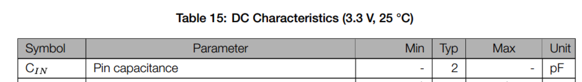

Anything from an ESP rep on this topic would be quite interesting.memory_stick wrote: ↑Tue Mar 30, 2021 1:26 pmWhich brings me to the BIG question:
What is the input capacitance of the ESP32 internal Pierce oscillator?

Hi @memory_stick,memory_stick wrote: ↑Tue Mar 30, 2021 1:26 pmWhat is the input capacitance of the ESP32 internal Pierce oscillator?
The capacitance of pins is provided in the chip datasheet. Below is the value from ESP32 Series Datasheet v3.8
