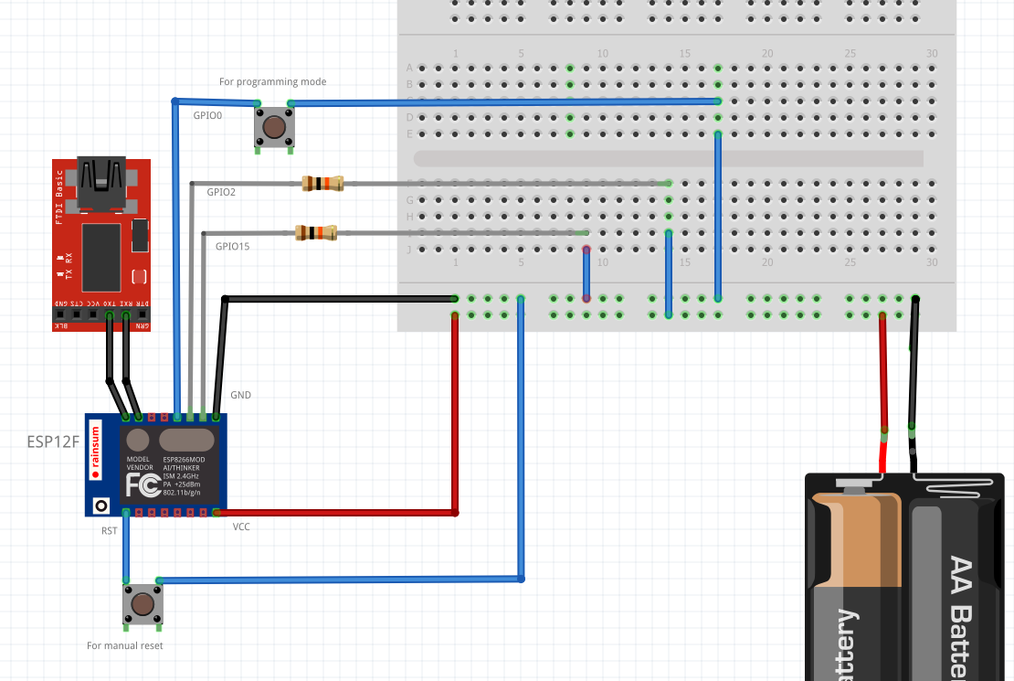

Hello, sadly the behaviour with your code is exactly the same, just since you use time-based wakeup, it will automatically show the strange behavour of the first reset once the wakeup timer expires (which also is a bit confusing me since i didnt do any explicit wiring from GPIO16 to RST, but that is another story).
Here is my current circuit:
And i used exactly the code you posted just with bit shorter waiting times to be able to reproduce quicker.

I can repeat this behavour every time, only the second manual reset will get the chip to start properly.
I am quite sure the code is not the problem since it is not running at the time i press the reset, neither the first time, nor the second time.
My circuit follows https://circuitjournal.com/esp8266-with ... g-to-esp12 just i added a pull-up to GPIO2 because i found some pages where this was recommended, but it actually does not make any difference for me (i think it just may not be pulled low)
