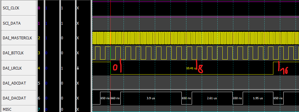

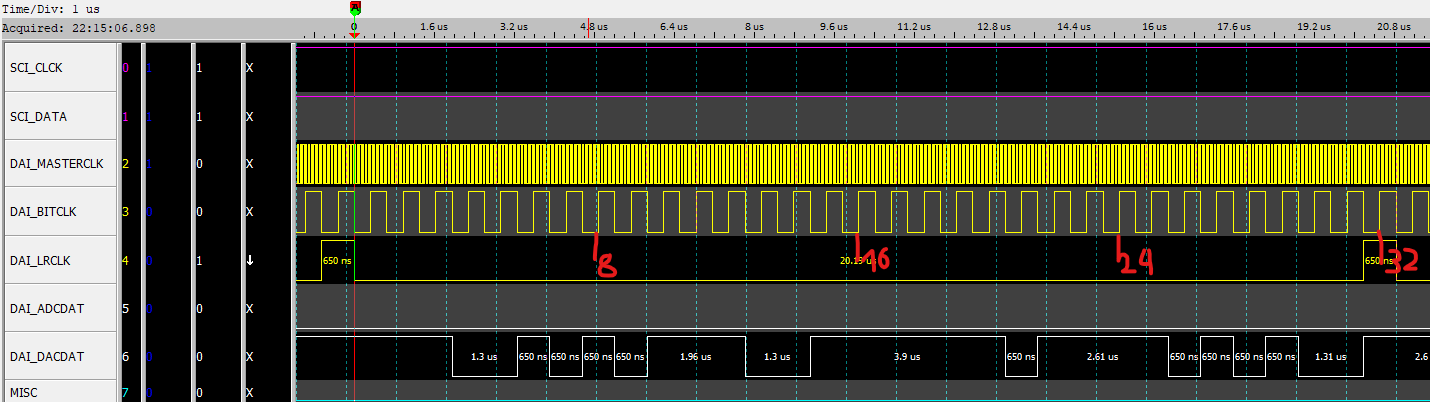

Now when I start the example and listen through the headphones, I hear a short klick every time the stream starts, followed by 7 seconds of silence and another, more quiet click when the stream terminates. In the console output you can see I added a register dump of all the register values after configuration. I checked them with the register tables in the data sheet and they are correct. So I started monitoring the bus with an LA (Screenshots added in the attachments) and here is what I found: In both, PCM Mode and I2s Mode (Philips Standard), the ESP seems to be a one bit short.

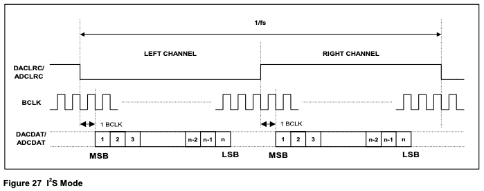

Unfortunately, I don't have a LyraT-Board here to reproduce this scenario, however I didn't touch the I2S driver in any way. Of course I checked back with the I2S timing diagrams in the ESP32 reference manual and it really seems to confirm the issue. Here is the Philips-Standard diagram with the data starting on the second rising edge after the Word-Clock Falling Edge:
Do I miss something here or is there actually something rotten in the state of Denmark?
