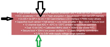

johnlee wrote:about the supply voltage range. the main issue is not with ESP32, but with the flash chips which usually runs off 3.3V, with the exception of some vendors which went as low as 2.2V. with ESP32, we decided to try using 1.8V flash; hence we can now go to 2.0V.
ah, thanks john.
can you say about i2c too. is this a mistake ( 3x i2c ) - have we 2xi2c like datasheet?

Rudi: Just checked the techdocs: the ESP32 has 2xI2C.

ESP_Sprite wrote:Rudi: Just checked the techdocs: the ESP32 has 2xI2C.
txs!
puzzled
because there was "right" changes in the tweet too ( john confirmed )
and 3x i2c was written, but we have in technical 2xi2c.
