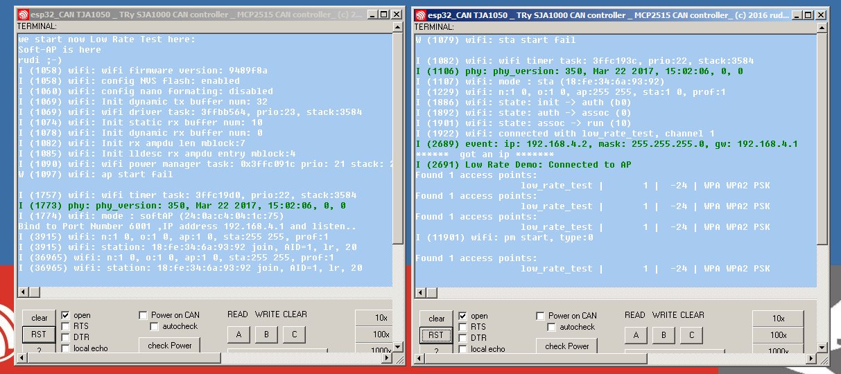

Postby rudi ;-) » Wed Mar 29, 2017 8:52 pm
@ivan
how does this looks to you ;-)
will test on weekend the thing outside.
txs for allways teaching us in the right position!
SoftAp: DevKitC V 2
Station: ESP32 Demo Board V2

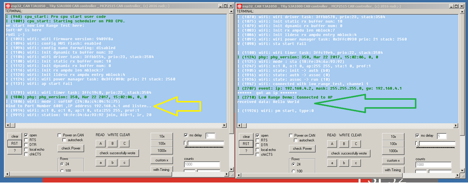

Postby rudi ;-) » Thu Mar 30, 2017 12:58 am
Could not wait and not sleep
think it looks good..
the world's first "hello world" with low rate on esp32 ;-)
done!
left tcp server with low rate
listen
after client connect , send hello world
right tcp client with low rate
connect and receive data

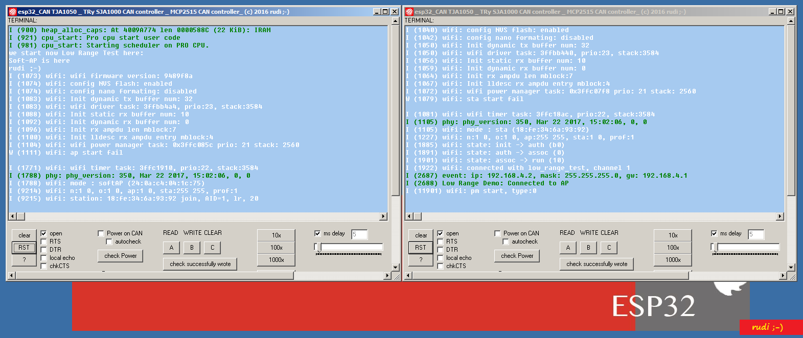

Postby rudi ;-) » Thu Mar 30, 2017 3:49 am
ok, ready now for walking/flying
will add ping response time and GPS :)
