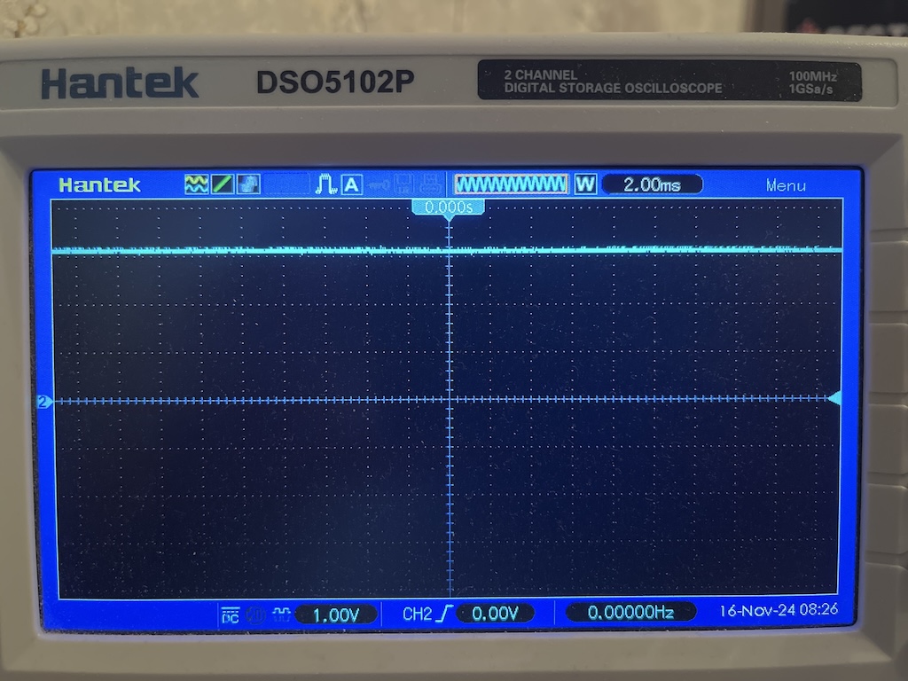

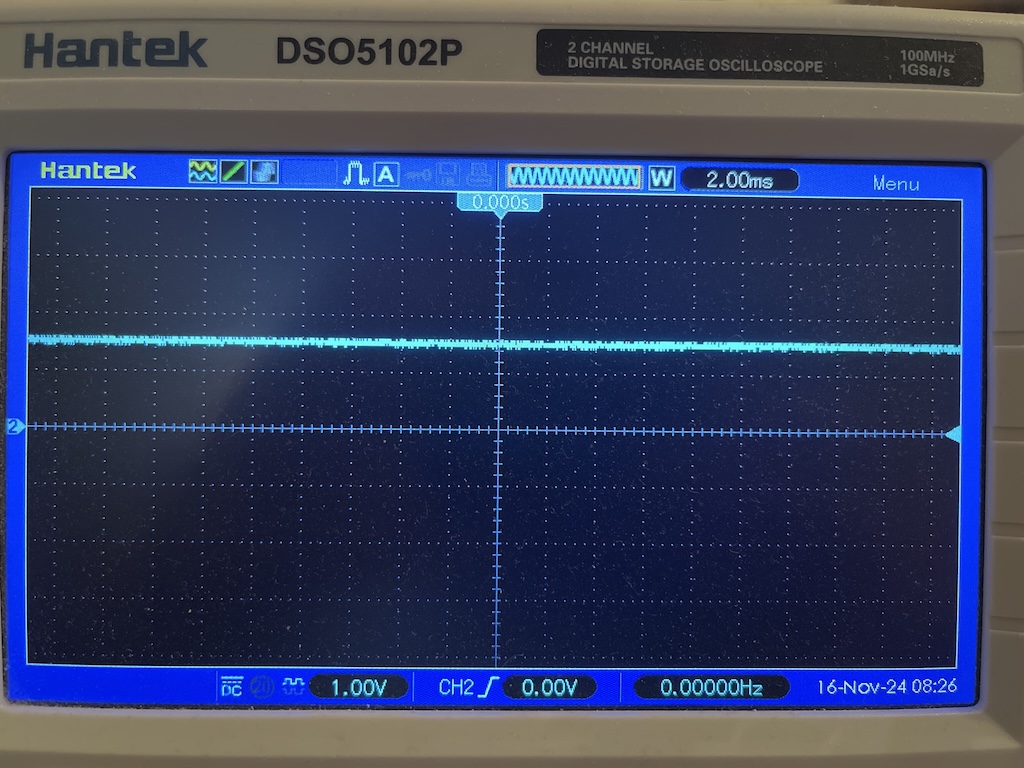

I'm reading the value from ADC1, but at the moment I'm trying to read the value, the voltage on the pin to be dropping.

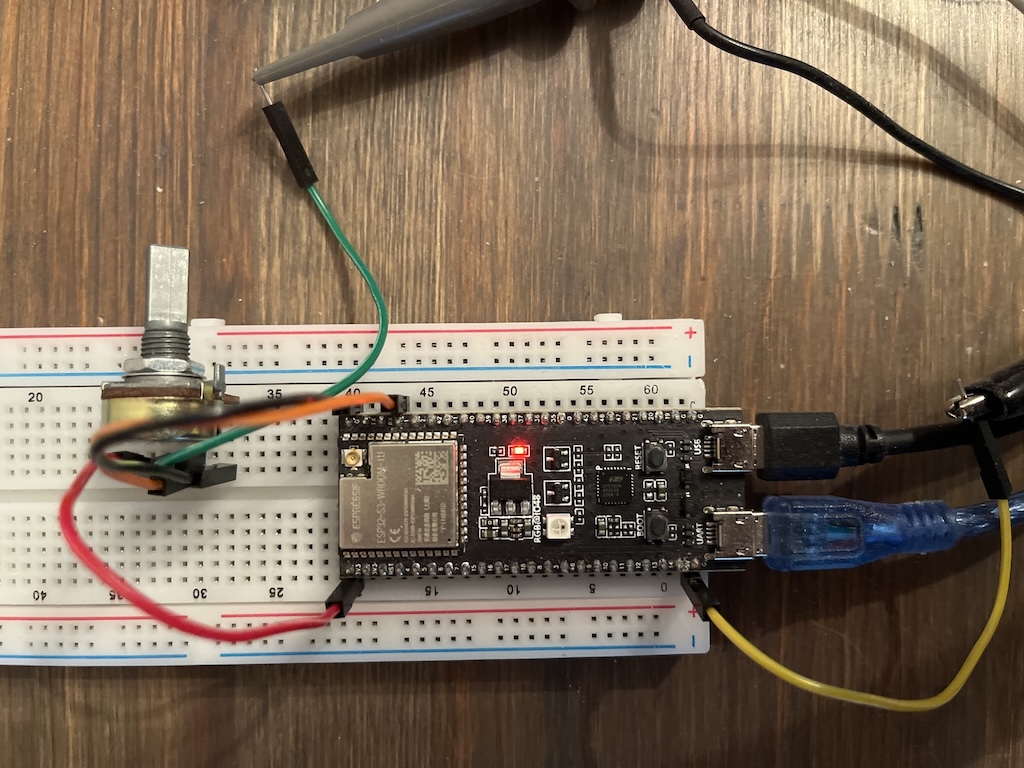

Board: ESP32-S3 devkit
OS: NuttX
adc mode: one short

Level after read value
Level before read value
Connection the board
