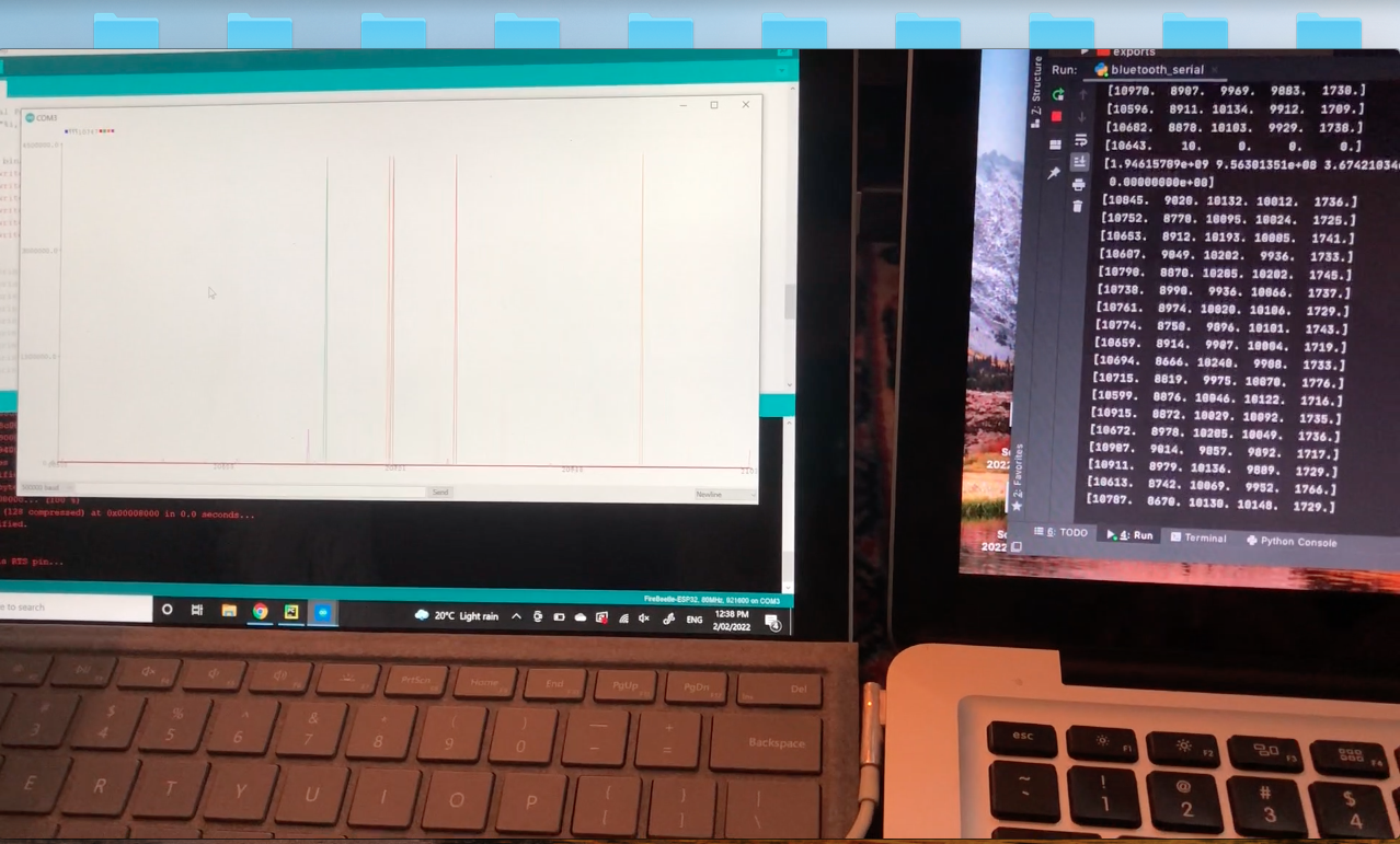

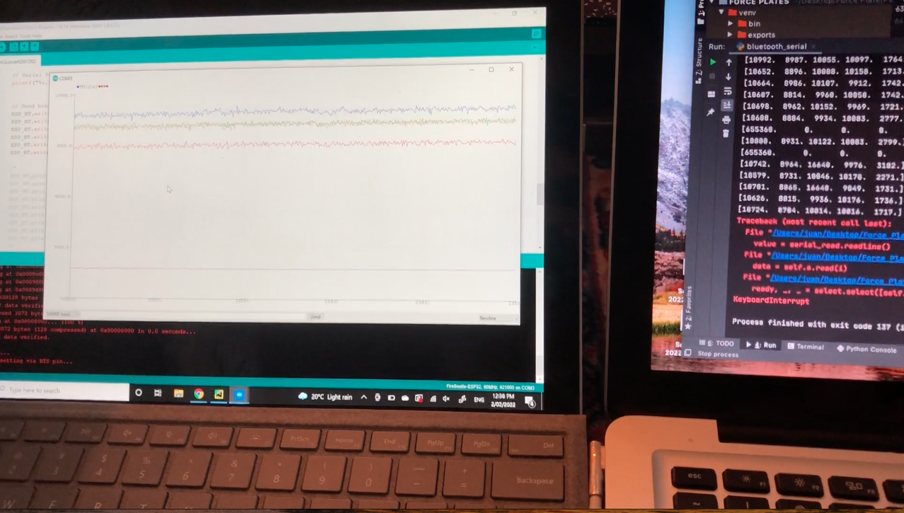

Thanks ESP_Sprite, admittedly removing those two lines fixed the core panic issue I was seeing. I had to move around the sequence of initialisation in the setup() to get the Bluetooth to work properly. For example, sometimes I cannot connect to the ESP32 bluetooth port on my Mac saying 'resource busy'.
I am also experiencing the following behaviour which is very confusing:
Case 1: I send the ADC data over the software serial port, the data is good.
Case 2: I send the data over the software AND bluetooth serial, the data is good ONLY IF viewed over the software serial port.
Case 3: I do as above and open the software AND bluetooth port, the data is corrupted at random, recurrent intervals. As soon as the bluetooth port is closed the data is good again on the software serial.
Case 4: I only send data over the bluetooth serial port, the same periodic data corruption is present.
(Attached photos of behaviour)
I know for a fact that if the ADC data read routine does not happen fast enough, the data can be corrupted because the SPI communication is reading the ADC register as it settles to new values. However I cannot understand how opening the bluetooth port could case additional latency in the ESP freeRTOS if the bluetooth serial data is being sent regardless of the activity on the PC side (i.e. port open or closed).
Any thoughts on this would be a lifesaver! :)

All good ESP_Sprite! I managed to debug it, it has nothing to do with the functioning of the ESP32 or the bluetooth. I was using "\n" newline characters that are showing up in my data and therefore getting split data packets when I should not have. Thanks again for the rapid responses and assistance!
