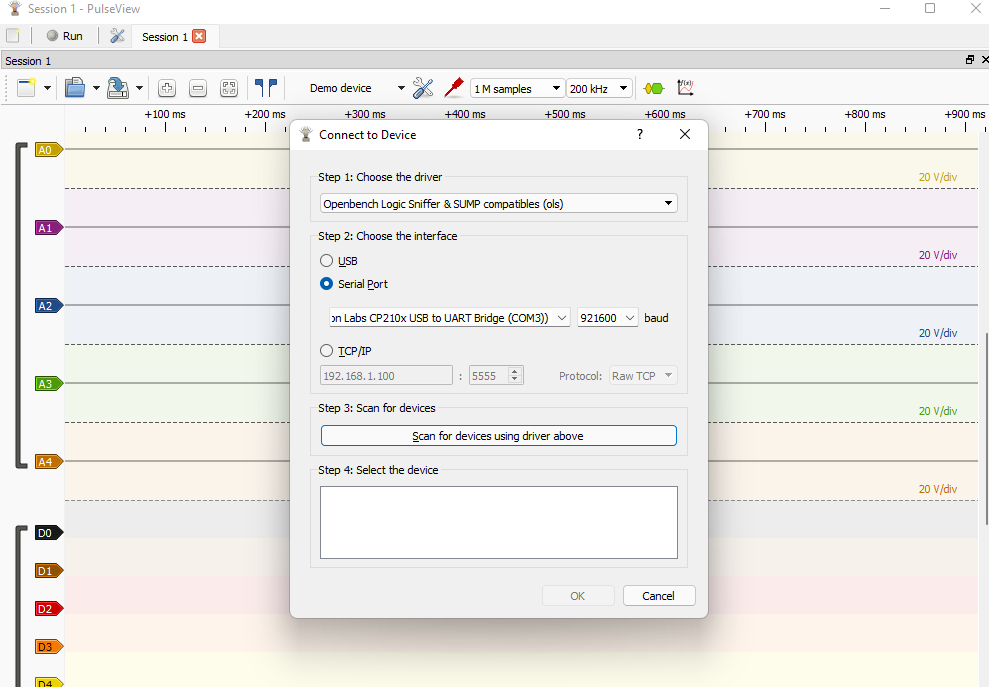

Now what I didn't find so straightforward is the pulseview interaction. I could not figure out what it takes to connect to the ESP, what device to select, how to probe the port, etc. I see the nice screenshot on github but I can't seem to get that. Any quick instructions? Suggestions?

I am new to ESP32. I have a ESP32 Wroom32 module. I downloaded the code from the Github repo, added #define USE_SERIAL2_FOR_OLS 0 in ESP32_LogicAnalyzer.h and uploaded the code to my module from the arduino IDE but PulseView doesnt detect the board at all, I have followed instructions from the Github Issues for this repo but still no luck. Please help.
- pulseviewpng.png (63.06 KiB) Viewed 1020 times
