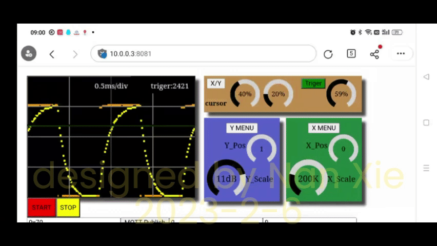

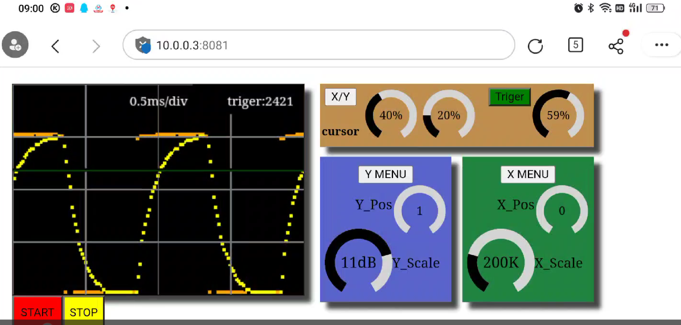

A demo now, under developing.
Two-channel, 150 ksps/ channel, for single-chanel, 2Msps.
Communication with mqtt, also support coap or Matter for future.
y-axis, 4095 bit resolution.
1V, 1.33V 2.66V, 3V four measurement scale.
mobile, ipad, PC support.
no APP or exe, just scan the two-dimensional code, control the device with your browser.
This case is used for education, since the pricision is not too high, but the web interface could emulation the real oscilloscope. And this demo just add the curor function.

If I remember rightly, S2/S3's adc only support 100ksps, somehow slow for an oscilloscopes, but more expensive.
If the USB transmission is need, the USB to serial port may be more convenient. Native USB may be more fast, but difficult to develop.
Several oscilloscopes company have launch cheap oscilloscopes based on STM32 with 1Mbps, and its adc is more accurate than esp32. They have local screens and buttons. But if the company want to add usb connectivity, it shouldn't be too difficult.
The NI acquisition card is now ~500 yuan in china, 48kS/p, 14bit, usb-connected, high precision and powerful software ecology.
Maybe you could evaluate these situation, if you find some application scenarios really need S2/S3 for their large computing resource, please tell me and I could give a edition with USB to serial port and co-operate.
