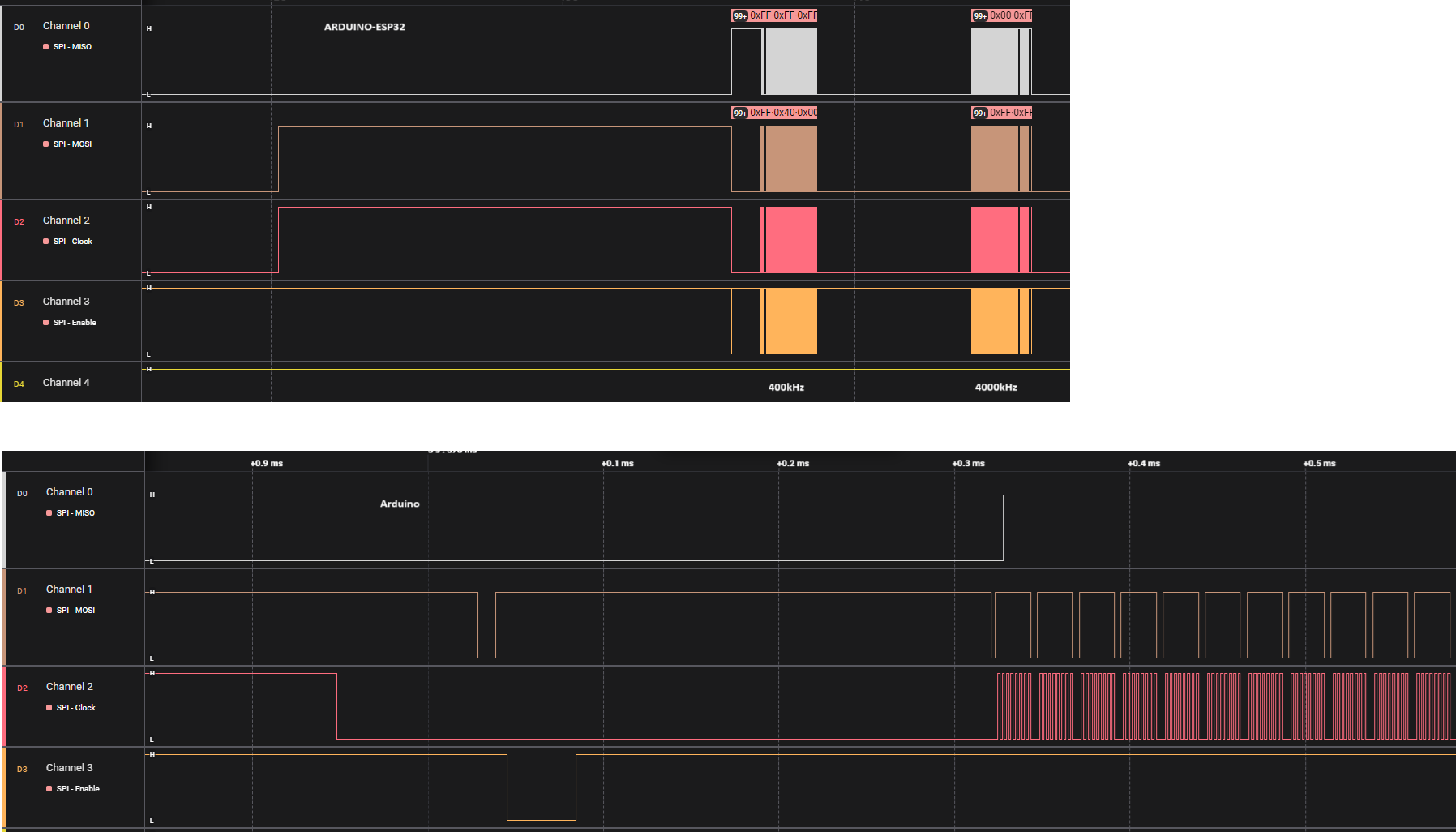

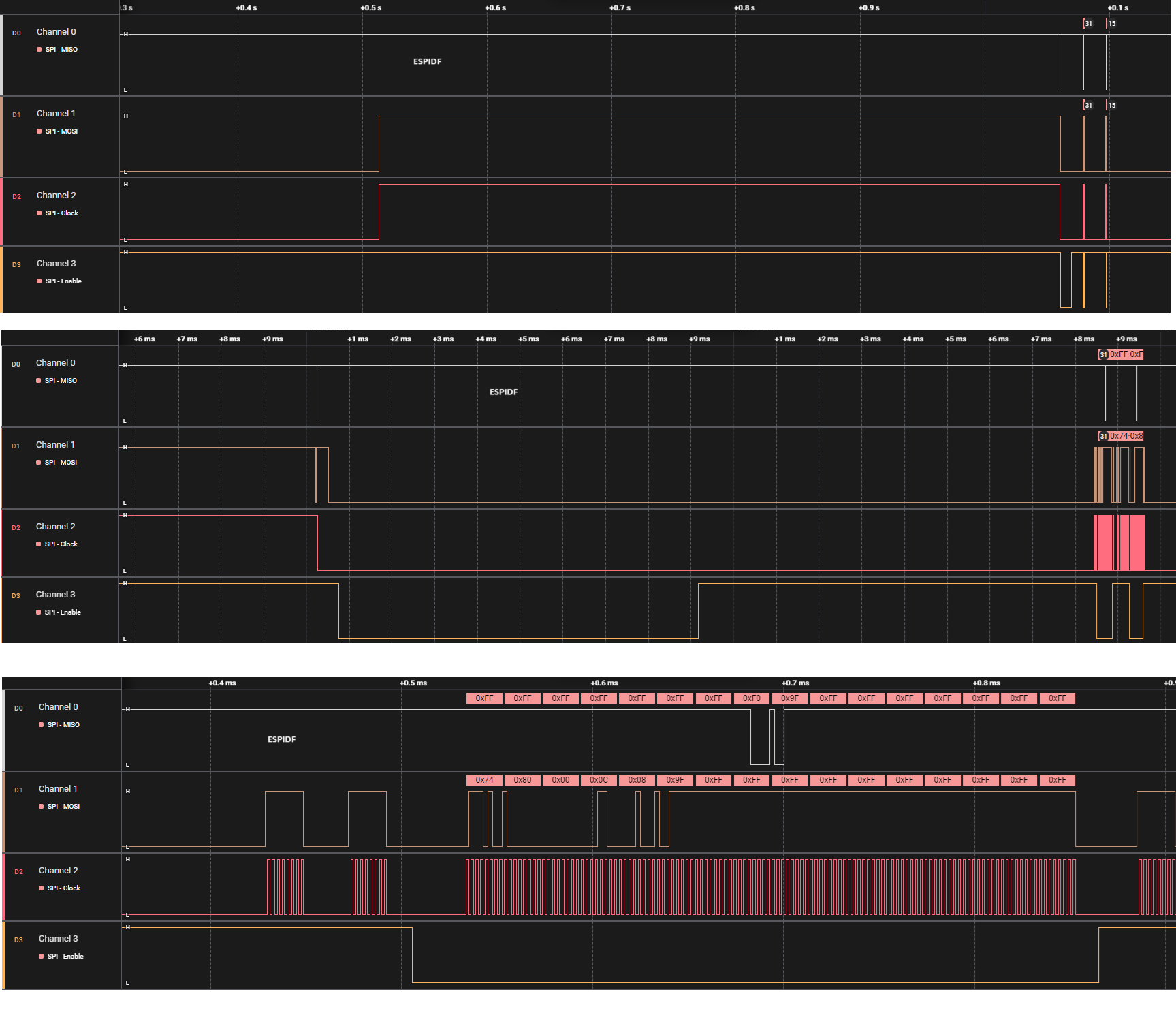

I have tried lowering the frequency to 4000kHz as I have read in other posts but nothing.
On lowering the frequency I did several tests and noticed that:
- Arduino-espidf starts with a frequency of 400kHz and then does the data transfer in 4000kHz
- ESPIDF I can only see that it starts with a frequency of 400kHz and then I can't detect anything else because there is no transfer and consequently any frequency value has no impact.
Below you can see the physical behaviour

is it normal that pin 38 (CS) is put first as output and then as input?
finally from the graphs above you can see that the MISO wire with Arduino is normally HIGHT while with espidf it is normally LOW and yet the 10k pullup resistor is present.
