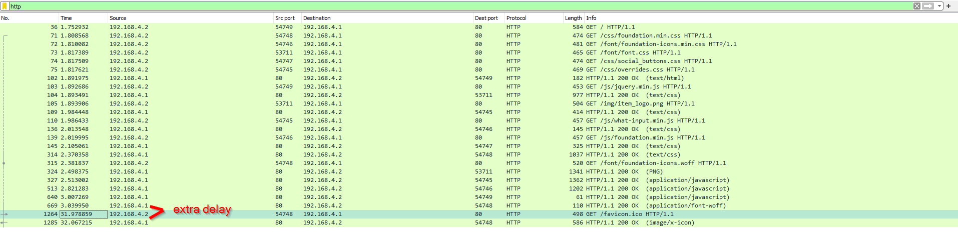

The problem I am experiencing is that the browser needs quite a lot of time to finish loading the webpage. There is some extra delay (typically 10 - 30 seconds) before the browser sends the last request for getting the favicon.ico. The browser keeps spinning for quite a long time (in this case about 30 seconds).
2024-01-08 13_03_56-Window.png (54.11 KiB) Viewed 25354 times

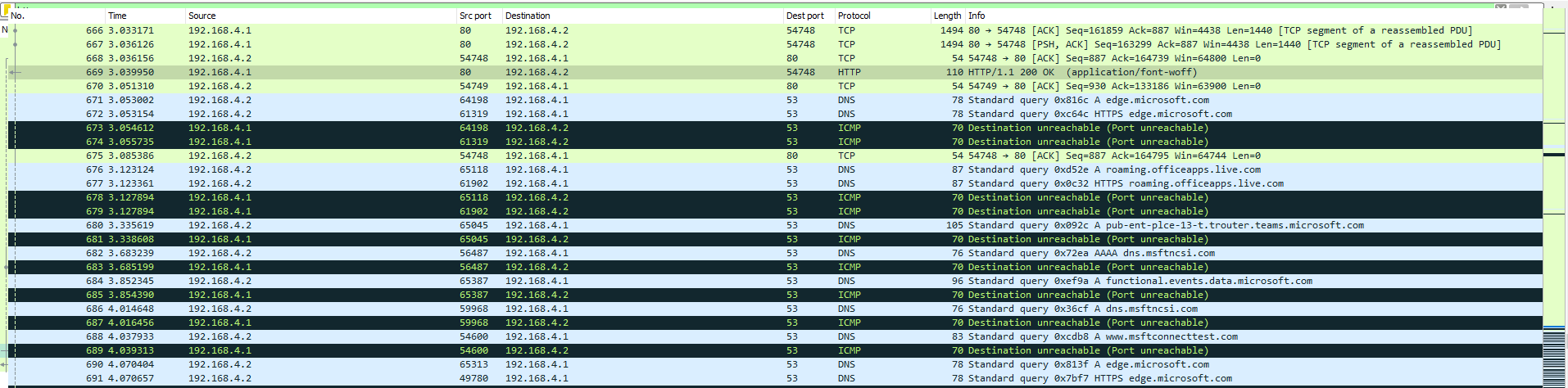

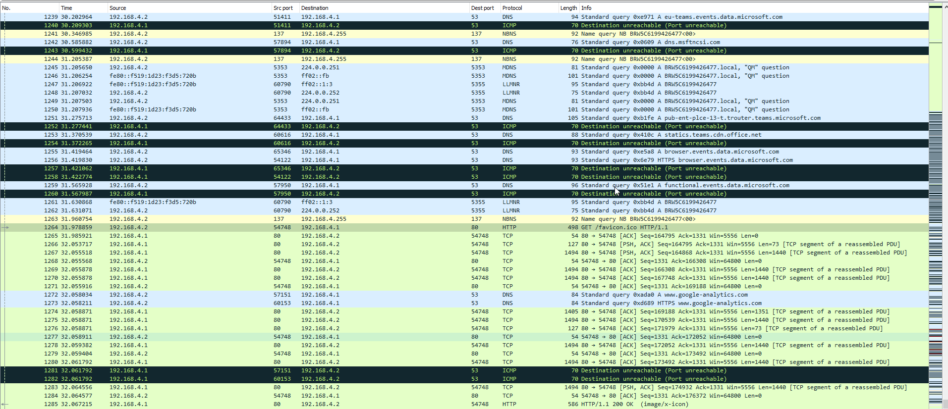

Looking from the wireshark, it seems that there are a lot of DNS requests and ICMP errors generated during this delay.
This is how it looks like before the browser requests favicon:
2024-01-08 13_28_42-Window.png (120.36 KiB) Viewed 25354 times
It seems that this extra delay is caused by the DNS requests from browser. So how should I solve this problem and reduce this extra delay? with captive portal? or different configuration in mDNS and AP mode? I am very new in this area, so any suggestion would be appreciated! Many thanks!
