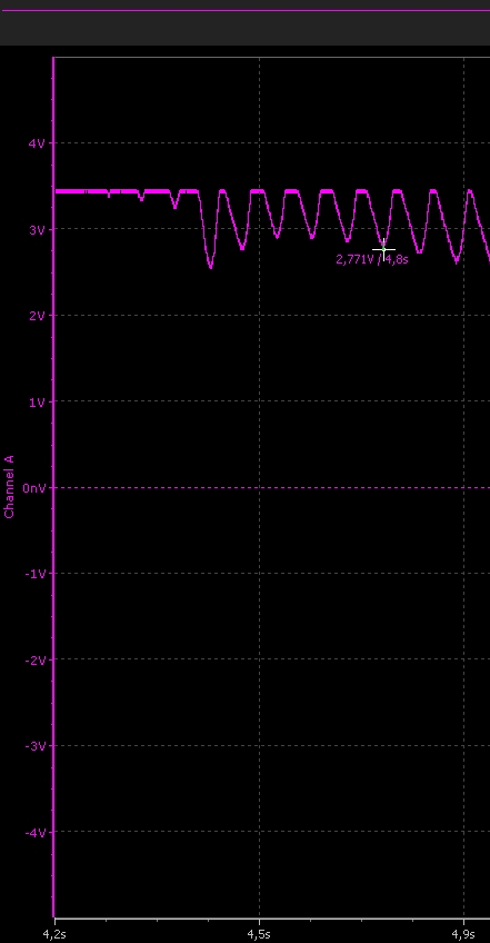

I did some further measurements. measurementcycle-1.png shows the drop in input voltage with each measurement cycle of my ESP32 application. This is the minimum hysteresis that is needed (about 0.5 V, 0.65 V would be better). Furthermore I attach fadeout-2-valid.png, which shows the voltage plot when getting to lower speeds: Each hub dynamo partial rotation bringing current in from the next armature. These can lower the voltage by up to 1 V (thus getting close to the minimum voltage needed for the ESP32). Ideally, this would also be covered by the hysteresis. So far, I did not find any supervisor IC that set EN at 3.4 V and keeps it until 2.5 V. Any suggestions?

In that case, you may want to hand-roll a solution. For instance, this document has the schematics to make a comparator have hysteresis. For Vref, rather than a voltage divider, you'd want to take a fixed voltage reference, e.g. the 0.7V drop of a diode or a zener or something. For the input voltage, you'd want to scale the battery voltage down (using a resistive divider) to come in range of that 0.7V. Then you'd run the calculations to get the hysteresis you want. Connect the output of the comparator to the EN pin of the ESP32, and you're good.
Re: ESP32 lower startup power consumption?
Another option is a supervisor IC selected to ignore voltage drops of a short duration. TPS3899, for example, has a programmable sense delay using an external capacitor; if the voltage rises above the threshold again before this time expires, it will do nothing.
